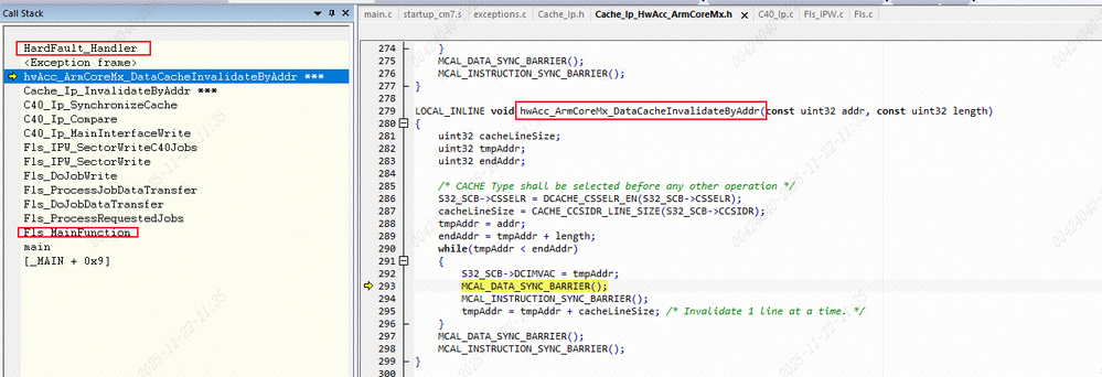

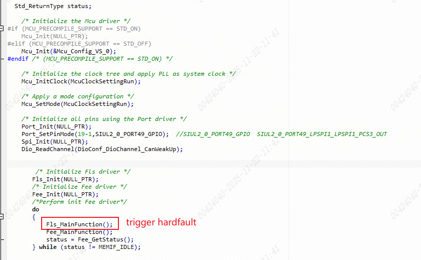

hello :
When I debug the FEE module, I just do the initialization operation and call FEE/FLS mainfunction. A hardware error will occur. Please help me analyze the problem. At the end of the program, a hardware failure is triggered in this function hwAcc_SrmCoreMx_DataCacheInvalidateByAddr.

Hi@yexiaoer
I checked the configuration file you provided, and I found that you are still using RTD 2.0.X, while the latest version has been updated to RTD 7.0.0.
Therefore, my suggestion is that you update your RTD version to a newer one. If you still encounter similar problems, I can spend some time helping you reproduce and troubleshoot them.

EB Tresos Version: 27.1
Fee_Fls_cfg Include ; Fee.xdm Fls.xdm
