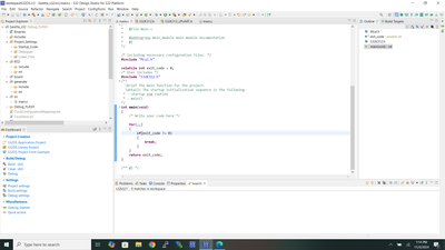

I have successfully created an application project using the S32K3 series MCU (S32K312) but I am unable to find drivers for UART, PWM, GPIO, ADC. I need to configure all those. Someone suggested to find the drivers in the component tab under the project explorer, but I couldn't find the components tab in my project explorer. Help me to configure and solve the issue.

Since you are creating an S32DS application project using RTD software, before working with the driver files, the configuration and all components must be generated.
  1. Go to Project Explorer View in S32DS and select the current project.
  2. Select the "S32 Configuration Tool" menu and click on the desired configuration tool (Pins, Cocks, Peripherals, etc).
  3. Add the drivers and make the desired configurations.
  4. Click on the "S32 Configuration Tool > Update Code" button.
