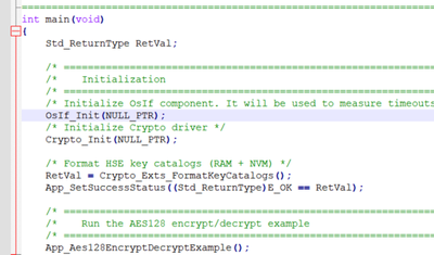

Yes, I refer to S32DS for S32 platform's Crypto demo. This question is in link(S32K324 Crypto returns CRYPTO_RET_OPERATION_TIMEOU... - NXP Community). When I debug App_Aes128EncryptDecryptExample in s32k324 board, it returns timeout error.
In the beginning of main(), it don't need to init clock or mcu(Mcal) module?

Hello @Faker,
Yes, because FIRC was initialized by the HSE core when POR.
Did you use correctly the chip's name (E5) with HSE FW release?

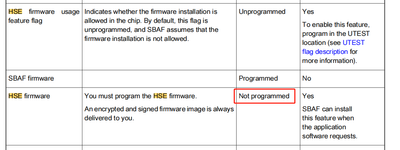

In chapter 31 boot overview of S32K3XXRM.pdf, there is a table that shows some content about HSE FW.
Following this picture, K3 chip don't program HSE firmware by fault,so the crypto's function can't work?

1. If your chip has "E5" on the surface, then it is an E5 chip.
2. Following this picture, K3 chip don't program HSE firmware by fault,so the crypto's function can't work? => That's correct.
3. Please use the chip correctly with the HSE FW version.

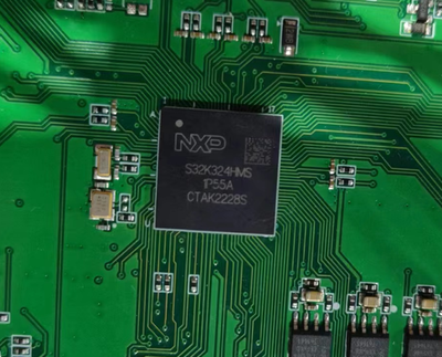

This's a chip(S32K324HMS) on my board. Don't have the prefix of "E5" . Does that mean I can't use encryption.
9,910件の閲覧回数
DanNguyenDuy
Hi @Faker,
Unfortunately, the S32K3 package was only tested on the S32K344, S32K312, and S32K342, and don't test with S32K324 because we don't have this derivative.
Hence, I can't ensure whether or not S32K324 can successfully load HSE FW.
From my point of view, you should try to install HSE FW and check whether the Crypto example can run successfully or not. If the result fails, this indicates that your chip can't load the HSE FW present.
Dan
