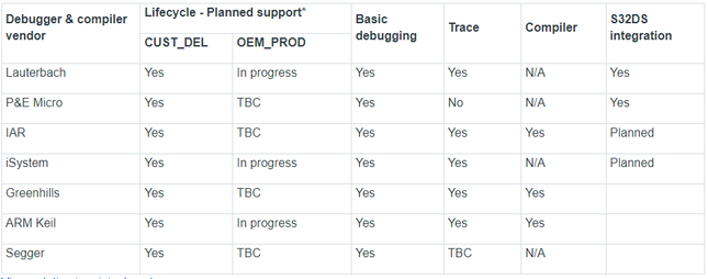

I want to use Jlink on S32K344, but the current board simulation is not normal, I want to know when it can be resolved?
11 Replies
15,191 Views
Senlent
Hi@ye_jiawei
          For now, J-LINK does not support for S32K3 in S32 Design Studio, and I have confirmed with the AE team, the specific release time is unclear.
          The latest Ozone provided by Segger's official website supports S32K3, and colleagues from AE have confirmed this.
BR!

      Can you please confirm whether S32K312 supports the segger fully as of now? and if so, the support related to S32K312 [ With FreeRTOS ] - where we can find?

Hi, Please provide the support for Integrating the seggerview to enable the continuous recording through UART[S32K312 Platform] and tell me if it is supported for S32K312 platform with FREERtos enabled or not.
