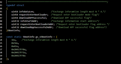

hello, there is a  question to be wroked out , i want to know ,in S32K312 's link file , if i want to set a flag which is used for app vaild flag   in ram ,and after soft reset,the flag will not clear , i must set the flag in  the standby ram or not?  in demo called unified_bootloader_demo_v2.1 ,i found  the flag was set in the lastest section as blew:
zq1_0-1711090569086.pngzq1_0-1711090569086.pngzq1_1-1711090620877.pngzq1_1-1711090620877.png
hope your reply ,thank you very much.
