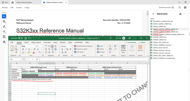

Senlent
Hi@michael_gao
you can find all the pin map of S32K3 in S32K3xx Reference Manual 's attachments.
Also you can find below describtion:"Pinouts with the same color indicate same pinout is used"

michael_gao
Dear Senlent
So I think the document has a wrong.
I can't see S32K322_172,  S32K314_172 and S32K324_172.............
always S32K344_172.

Senlent
Hi@michael_gao
so"S32K322_172,  S32K314_172 and S32K324_172" pin map can refer to S32K344_172
