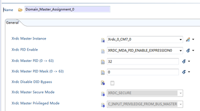

When we use MCAL(version: SW32K3_RTD_4.4_2.0.0) RM module to config S32K344 XRDC function, we would like set some Peripheral to "Non Secure access policy = XRDC_NO_ACCESS","Secure access policy = XRDC_FULL_ACCESS", but we found that "Non Secure access policy" configuration don't work, maybe cpu still in secure mode.
So we try "Rm_XrdcSetProcessID(XRDC_CORE_M7_0, 0, XRDC_NON_SECURE)" to set
PID to 32(bit 5=1) , but XRDC still don't work,  can you help me to set non secure mode?
And MPU can't prevent writting by user mode(CPU control = 1)
