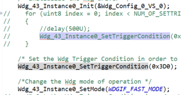

Hi,all,

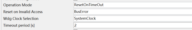

   I've recently been learning the routines for software watchdog, but I can't find the API function for feeding the dog. On the GUI, I set the "Operation Mode" in the quick mode to the immediate restart mode and set the timeout period to 2s.
  I would like to ask if the API for feeding dogs is' Wdg_43_Instance0_SetTriggerCondition '? If not, can you give some good advice? Thank you very much!

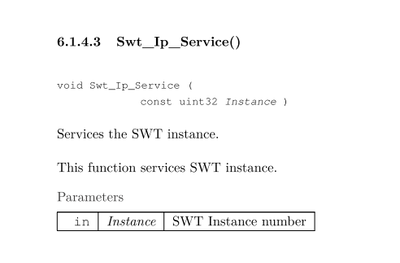

I do not know to which driver you are referring, but it should be always in driver documentation.
Looking at RTD v4.4 1.0.0 I can read:
