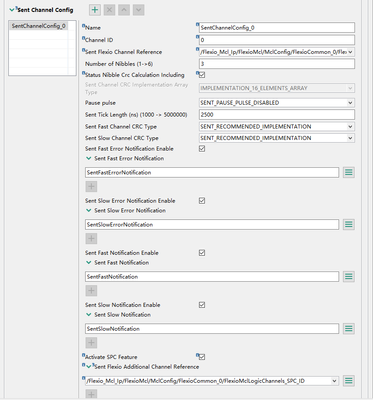

I found some errors when I tested with Valeo's sensor. 1. The waveform of SPC is inconsistent with that in the manual. 2. There is an error in the CRC check of SPC. 3. The trigger segment will be identified as an error. The following is a detailed description:

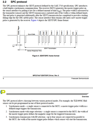

1. The waveform of SPC is not consistent with that in the manual. In the manual, I see that the length of the ECU trigger segment, that is, the ID segment, will be affected by the length of the low level (the two falling edge events will change). The waveform I tested is that the length of different low levels only affects the duty cycle (the two falling time edges are fixed).
2. Error in CRC check of SPC.
The standard CRC check cannot verify the SPC data and needs to modify the CRC. There is no problem with the default CRC algorithm for verifying SENT data.
When I test, the trigger segment is captured by SENT and a STATUS_FLEXIO_SENT_IP_ERROR_CALIBRATION_LENGTH error is reported.

I just found a document AN4856 about the SPC driver, please help me to check.
1> In chapter 2.2, the SPC protocol said that we have three pre-programmed for the Hall sensor TLC4998C, please check your sensor about the modes supported by the sensor. Mode 3 can be the pulse-width that you want, but for mode 1 and 2 it's not.

- Please share your SPC implementation, the code where the Sent_SpcRequest functions is called.
- Please send some pictures regarding the waveform of the signal. What you expects the trigger to be and what is the result. Please share the the values of the trigger that he sends and what he sees actually with the analyzer.
- About your setup, how many sensors did he connect to one SENT channel? What mode does he use-synchronous mode, synchronous mode with range or ID mode?

     I'm sorry for the late reply.There are no three modes for S32K3 to configure.
about CRC
     I didn't make many changes to the configuration of NXP routines, just tested SPC.Flexio_Sent
In my tests, I modified the TimeTriggerPulse parameter of Flexio_Sent_Ip_SpcRequest (), and the resulting waveform only changed the low-level duration  (260us) .   The waveform I mentioned earlier, TimeTriggerPulse is 60. I think this fixed period may be the reason for the sensor.

The Trigger time from master should be the low level signal here, i saw your measurement and i think it's work because i guess the low time pulse here will be around 160us (out of 260us in the deltaX that i saw in the signal capture)
The defined TimeTriggerPulse is the time period in microseconds (us) to keep the pulse low.
Your signal quite the same with this example, for 3 nibbles data
As about the ID, please describe your hardware setup, like how many sensors did you connect into one channel SENT?
If one sensor be connected to one channel SENT with the defined TriggerTime so it'll work in mode 1 properly.
One comment from my collegue, that you should call function Sent_SpcRequest, shall be called periodicaly at an interval of 1 milisecond.
The call of the Sent_SpcRequest shall be done after:
  • Sent_StartChannelReceiving in interrupt mode
  • Sent_GetFastMsgData in polling mode
As i saw that you call Sent_Ip_SpcRequest directly, and you already called Flexio_Sent_Ip_StartChannelReceiving (you're configuring SENT interrupt mode, aren't you?)
Could you please share your project so i can check your config and your implement code.

      I may have made a mistake. The screenshot of the SPC ID mode in the previous manual may be a concept map.
      I carefully read the chip manual, the actual waveform T (mtr) should be fixed, consistent with my test, 260us is about 90 UT. The sensor determines the ID through the duration of the low level.
