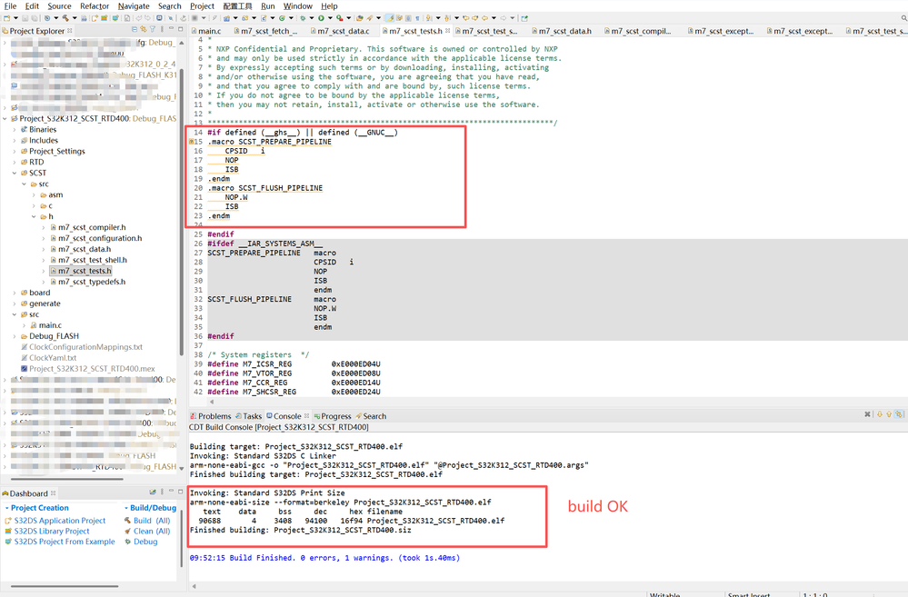

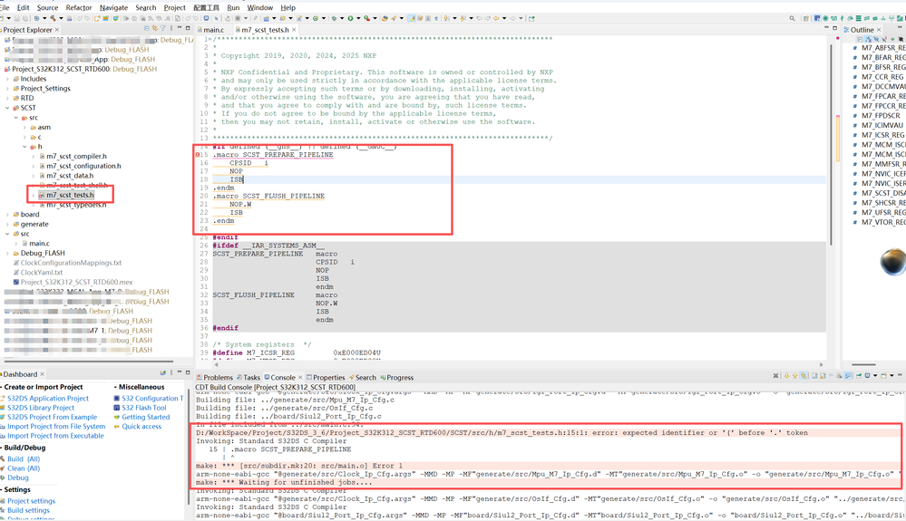

SCST lib integrated,m7_scst_test.h 报错.

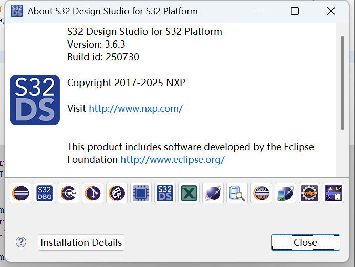

IDE使用S32DS 3.6.3
IDE信息

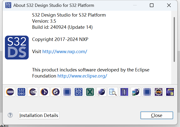

但同样的SCST程序,使用S32DS3.5.1就不会报这个故障。

RadoslavB
Hello @simonliu
seems that you incorrectly include m7_scst_tests.h from main.c
this header is supposed to be included only internally within SCST files.
Only SCST file included from main.c shall be: #include "m7_scst_test_shell.h"
Kind Regards,
Radoslav
