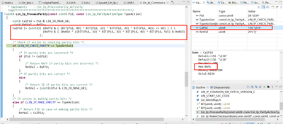

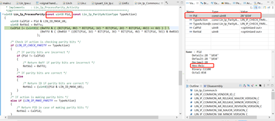

Question 1:
When I test the LIN Demo (Lin_MasterFrameTransfer_S32K344) provided by RTD, I can only use the ID: 0x1A in the Demo to send. It is not possible to switch to other IDs, such as 0x4, 0x1C, etc. Debug results show that it is in Lin_ Ip_ ProcessParity () was judged as an exception.
I can't find the relevant configuration item in the mex configuration tool. Which configuration item do I need to change.

Du_0224
Hello
Sorry, I have found the reason for question 1.
I confused the relationship between LIN ID and PID.
Now there is only question 2.
