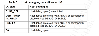

Hi:
In the five life cycles, whether the life cycle is advanced to OEM_PROD or IN_fILD, the key cannot be formatted at will.
3,772 Views
petervlna
Yes, there are restrictions.
You will need super user rights.
Please refer to HSE-B reference manual: 6.4.2 Execution rights (Super User vs. User)
Peter

youxi
hello @petervlna
When the life cycle is CUST_DEL, there is no restriction when executing the following functions. When the life cycle is OEM_PROD or IN_FIELD. Whether there are restrictions, such as requiring super user rights.
3,773 Views
petervlna
Peter
