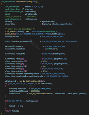

I‘m testing the functions of import key and export key of HSE. After importing public key, I tried to export, but HSE responded HSE_SRV_RSP_NOT_ALLOWED. Why is that? Is there anything else I need to do before exporting?
Export code as shown below:
