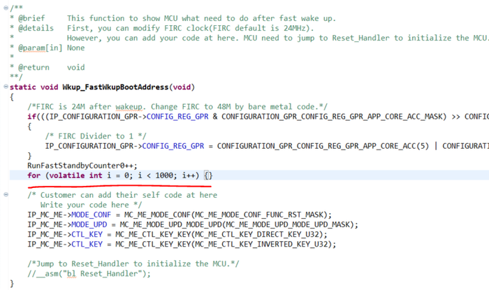

Call function reset in faststandby's wake-up function will cause the variables assigned in this function to not take effect.
These variables are all defined in standbyram.
It seems that function reset in the faststandby wake-up function will restore the standbyram to the state before entering standby.
But this will not happen if you jump through bl reset_handler。
What is the problem?

After spending a long time, I finally found that you just need to add a delay to ensure that the command
has enough time to execute.

It's so strange. How could a simple assignment statement take so long? This results in longer wake-up times。

This delay is just what I used for testing, not the minimum delay time.
But this should be the cause of the problem

But why is there no such problem through jump "bl reset_handler" ? That is no delay time.

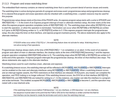

I tested this because after the standby wakes up, It will cause the WDI watchdog timeout problem using the fls driver to erase and program the dflash, but the function reset will not. Can you give feedback on this problem?

"I tested this because after the standby wakes up, It will cause the WDI watchdog timeout problem using the fls driver to erase and program the dflash, but the function reset will not. Can you give feedback on this problem?"
Is this a new problem?
Isn't it okay to close SWT before entering standby mode or before performing memory operations?

It is not the SWT. It is the wdog used for flash .

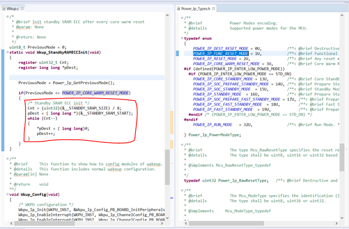

I guess it's because the program will Init Standby SRAM after function reset

I didn't init the standby ram when function reset, the var modified in the main function didn't lose

Could you please share the project so that i can reproduce your problem.
