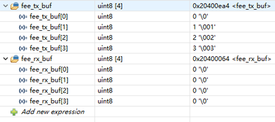

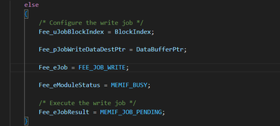

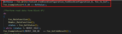

The S32K3 implements FEE. However, FEE_Read always fails and its return valueRetVal is 1.Do not use the following "else" statement:

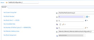

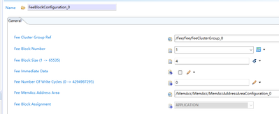

When reaching the "Fee_ExampleAssert" point, it is impossible to exit the while loop directly. May I ask what the problem is? Below is the EB configuration:
memory:

Thank you very much for your reply. I have carefully checked it and found that it was a problem with the underlying configuration. I found that the Fee Block Size and the Fee Virtual Page Size need to be in a multiple relationship for the operation to succeed.
