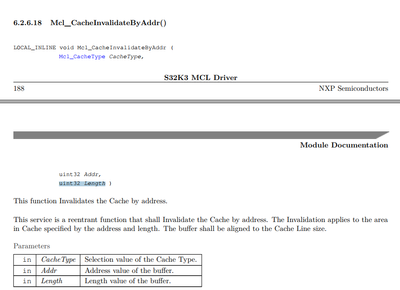

cuongnguyenphu
I think with #2, you can use API provided in Mcl module : Mcl_CacheInvalidateByAddr() with input params as:  Mcl_CacheType CacheType,  uint32 Addr  and  uint32 Length to invalidate Cache by address of specific DataFls region as you want.
In detail, please see in MCL User Manual document
