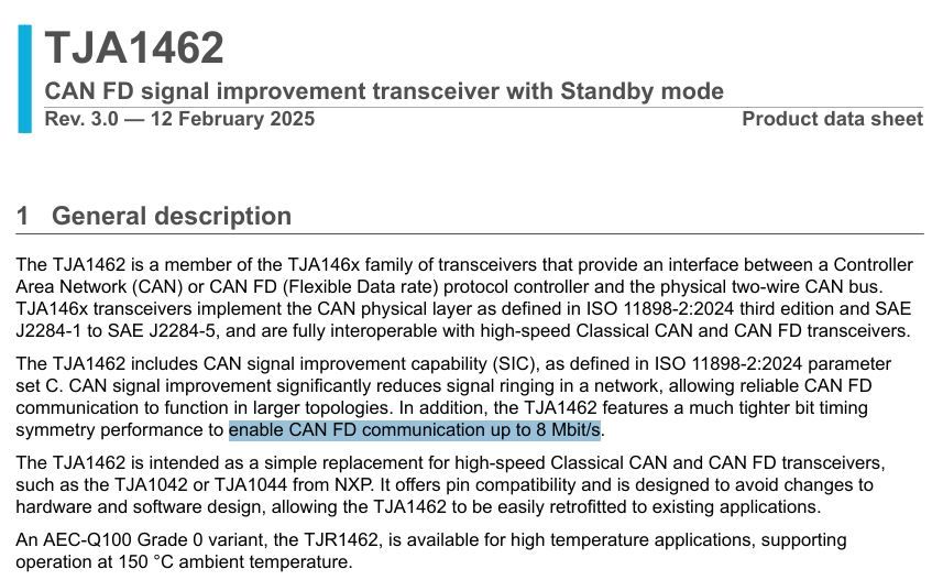

However question could be, do you have CAN transceiver which is capable to run on such rates? What is a board you have?

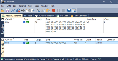

ok, do not have such combination, but I modified my old demo for MRCANHUB344, which have TJA1463. So I added test code for FlexCAN2 using 1M/8M bitrate and it is working well with PCAN USB Pro FD connected.
You can refer to that code.

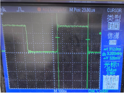

this is my measurement on CAN TX line, I see expected signal
Single pulse in data phase is 125ns, that corresponds to 8Mbps rate.
If you see timing issues, check CAN PE clock and CAN bit timing setting.
How many S32K3 CANFD frames can be sent and received per second by PCAN View?
An answer requires to have more inputs, bitrates for both nominal/data phases, payload.
You can see above a message with 1M/8M and 64byte payload take about 110us.

CherryDeng
Petr,
Thanks for your demo, we test the CANFD data bit waveform, but it is not 8Mbps, it is 3.205Mbps. Could you help check it?
