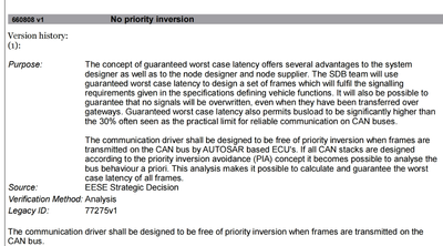

Hi,NXP experts
Can S32K314 driver be configured without priority inversion? and if so, how should it be configured?
1,320 Views
PetrS
by default, the FlexCAN module comes out of reset with CTRL1[LBUF] set to 0, which selects arbitration internally by CAN ID. The RTD driver maintains this setting, so configuring the module to use an arbitration scheme that prioritizes high-priority messages, thereby addressing potential priority inversion issues.
BR, Petr
