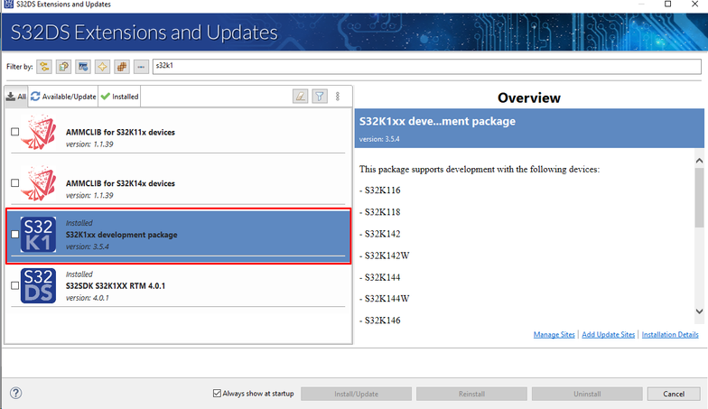

版本:S32DS for S32 Platform 3.4

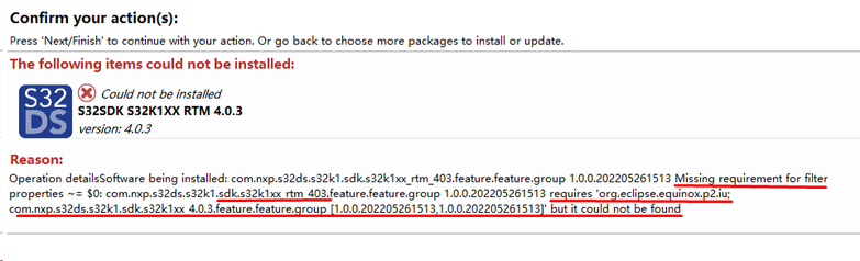

当我在线安装扩展“S32SDK S32K1XX RTM4.0.3”时,它说”作详情正在安装的软件: com.nxp.s32ds.s32k1.sdk.s32k1xx_rtm_403.feature.feature.group 1.0.0.202205261513 缺少过滤器属性的要求 ~= $0: com.nxp.s32ds.s32k1.sdk.s32k1xx_rtm_403.feature.feature.group 1.0.0.202205261513 需要 'org.eclipse.equinox.p2.iu;com.nxp.s32ds.s32k1.sdk.s32k1xx_4.0.3.feature.feature.group [1.0.0.202205261513,1.0.0.202205261513]' 但找不到”

As the error express. You are missing required package which should be installed before you install the actual one.
Do you have development package installed first?
