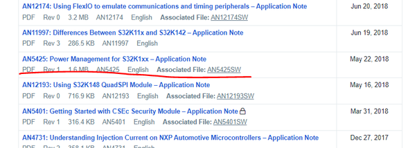

Senlent
Hi@945595199
those test cases could be find in AN5425:Power Management for S32k1xx
https://www.nxp.com/products/processors-and-microcontrollers/arm-microcontrollers/s32k-automotive-mc...
BR!
     Jim,
