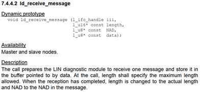

Hi @Francesco_Solito,
1) get a slave response to a diagnostic service like 0xB2 (that is included into the example); please note that NAD, PID and FID are ok;
=> As far as know, you can use the ld_receive_message() to receive one diagnostic message and store it in the buffer pointed to by user data.
Please refer to chapter 7.4.4.2 of LIN_Specification_2.2A.pdf for more detail.

Hello and thank you for your reply.
As regards my point 1: I solved it simply calling ld_init(LI0) before l_ifc_init(LI0). ld_init(LI0) was not present in the main.c of the example project "lin_slave_s32k118".
What I found now is that initial_NAD seems to be used only in 0xB0 service, while for all the other services configured_NAD is used. So, with a CANoe simulation, if I don't perform 0xB0 service at the beginning (in order to switch from initial_NAD to configured_ND), I'm not able to access diagnostic service (because CANoe uses initial_NAD while the lin stack uses configured_NAD). If I use 0xB0 at the beginning everything works correctly then. Is that correct considering the LIN specifications?
=> You are right. As far as I know, the initial_NAD is only used in 0xB0 service and configured_NAD is used for other services.
You can refer to chapter 4.2.5 of LIN_Specification_2.2A.pdf for more detail.
