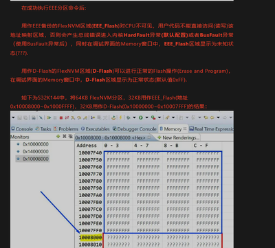

for FLASH, the default state is 1 after erasing, and the process of program Flash is the process of writing 0
1.The FlexNVM used for EEE backup is not visiible to the CPU.
   User code cannot directly access (read or write) this address mapping area, otherwise a bus error will occur and enter the HardFault or BusFault, and at the same time, in the Memory window of the debugging interface, the EEE_Flash area is displayed in an unknown state(???)
2.The FlexNVM used for D-FLASH
   In the debugging interface, the D-Flash area is displayed in a normal state(default vaule 0xFF).

Hi@ShaoTianzhi
我以为你说的EEP是指EEPROM的备份区域。
当FlexRAM没被用作EEPROM的时候,它可以和普通的RAM一样在上电初始化的的时候写入任意值。
当FlexRAM被用作EEPROM的时候,你写入的FlexRAM的值会备份至EEPROM的备份区域(FlexNVM),你可以设置上电的时候默认将EEPROM备份区域的数据同步到FlexRAM,所以FlexRAM的值和EEPROM备份区的数据一样。而作为EEPROM的备份区域的数据对用户是不可见的。
https://mp.weixin.qq.com/s?__biz=MzI0MDk0ODcxMw==&mid=2247486584&idx=1&sn=3b8651b928edd19c642b17838a...
细节可以看上面链接中的文档。
