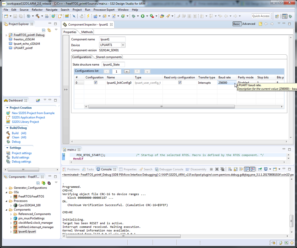

jiri_kral
you can set the full speed in processor expert lpuart module settings:
I tested the full speed with putty serial terminal - and it is working. For your testing you can use example project lpuart_echo.
Jiri
