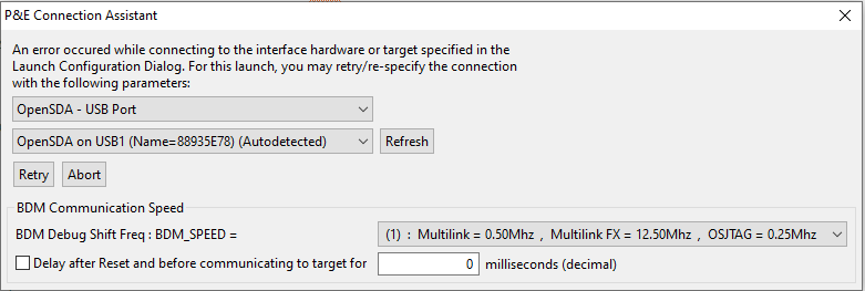

when i try to download my code in s32k148 card, i get this error :
and :

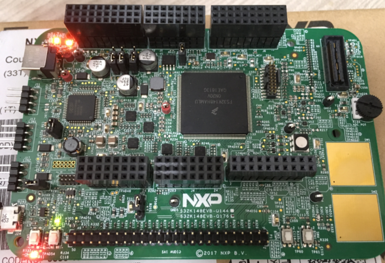

   - the reset LED is turned ON
   - the MCU is heating.
does that means that my card is damaged ? if not what can i do to fix this problem ?

I have met a few times that VDD and GND are shorted somehow.  You may check that using a multimeter. If that happens, the MCU is mostly damaged.
2,413 Views
Alexis_A
Hello Faress,
Unfortunately, due to the reset pin is being forced to a low state and the MCU is heating is very likely it stops working.
