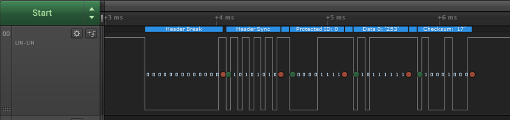

Which examples exactly have you tried?
Can you test the lin_master_s32k148 SDK example?
You should see this signal:

danielmartynek
Hi @argonaut,
In the example mentioned above, it is PTC9.

argonaut
Hi @danielmartynek
Thank you!
Can't find PTC9 pin on my board (S32K148EVB-Q176)! I've tried LIN1 and LIN2 pins - no luck. Probably not meant for beginner. No instructions or manuals how to work ok connect etc. Or my board is somehow a mess, cause all i see on picoscope, is just a 12v and no LIN messages.
