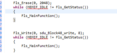

Dear Supporters,
       I use S32K 148 FlexNVM as a  Data flash, the driver (MCAL )is generated by EB.
After severals time earse and write, I get a error(RDCOLERR).
Could you give me some help?

Before erase and write FlexNVM, I already disable interrupt, and no DMA to this block. But it still get FTFC RDCOLERR.

Seems that you called Fls_MainFunction but not wait until the status back to IDLE before call for next time, could you try this way:
For every step to call command to Erase or Write Fls, you need to wait until the main function has done

I tried wait MEMIF_IDLE before  Fls_MainFunction(),  but still get FTFC RDCOLERR.
while(MEMIF_IDLE != Fls_GetStatus())
    Fls_MainFunction();

SO, how's about Erase function ? It's need to wait for Idle state also
4,019件の閲覧回数
TerryDuPower

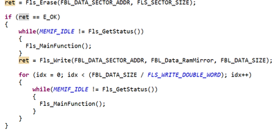

@cuongnguyenphu  Actually, I add both earse and write. It still get FTFC RDCOLERR.

Can you remove the line: for (idx =0; idx < (FBL_DATA_SIZE / FLS_WRITE_DOUBLE_WORD); idx++)
In my view, only 1 while loop is enough to write data to Fls sector, despite the data size of Data to be write into Fls.
