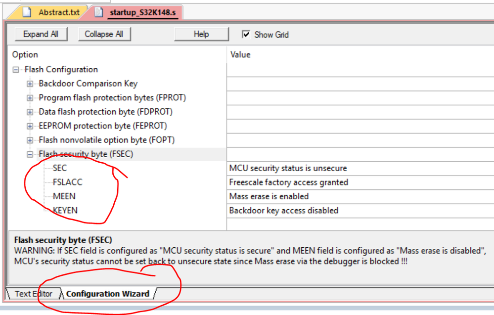

robertboys
Hello
The first problem I see is you need to get the SWD connection working.
The ULINKpro should work fine.
uVision supports P&E and also CMSIS-DAP.
In this document:  www.keil.com/appnotes/docs/apnt_305.asp
Page 7 describes how to get P&E working and Page 8 for CMSIS-DAP.
CMSIS-DAP file is attached.
I also had some problems - maybe with a 12 volt power supply it worked better ?
Also try these settings:
or Try Reset: Auto
I have it working perfectly now with CMSIS-DAP.
Check these settings:
Bob Boys

robertboys
Hello
If you are using a custom board and did not install a CMSIS-DAP processor - then you are unable to use CMSIS-DAP.s19 file.
I tried to connect to the 148 eval board and i had similar problems you experience.
I tried different RESET settings and slowed down the clock.  I had RDDI-DAP error (means CMSIS-DAP can't see target chip - usually because it is not powered or in a funny reset state) and can't stop target.  I cycled the target power  many times.  Using 12 volts appeared to help but I do not need this today.
I tried many things (using CMSIS-DAP OpenSDA) and it suddenly worked and now it works perfectly....even with a ULINKpro.  Twice uVision notified me the device was locked and I allowed it to unlock it.
With ULINKpro - try a new USB cable and being very careful not to disturb the battery - remove the case and un-connect and connect the 20 pin cable - I have seen a very few of these with perhaps bad connection ?
If you try something and fail - sometimes it might help to re-power the board and/or the debug adapter.
If you have a Segger J-Link - you might try this.
I just tried it all now and both CMSIS-DAP and ULINKpro work perfectly.  I have no idea why I had all the trouble yesterday.  I had never seen this before working with 144 or 148 board.  If you come to any conclusions, please let me know.
Bob Boys
[email protected]
San Mateo, California
