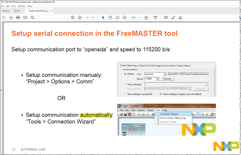

In trying to get Freemaster to connect to my S32K146EVB, I was following this solution:
https://community.nxp.com/t5/S32K/S32K146EVB-Quick-Start-Guide/m-p/1077560#M7567
but copied in bootloader mode. Now my eval board will not go back to application mode.
My questions are:
how do I get this back to the OOBE boot, where the lights blink.
how do I setup the communication between the board and my system. The quick start guide was incorrect in the setup, which is how I ended up here.
Is there any up to date guides for this board, the current one is riddled with mistakes and is not useable for a linux system which supposedly is supported.

Please follow the S32K146EVB-QSG

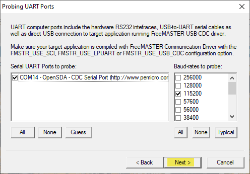

At "Setup serial connection in the FreeMASTER tool" page, I think you can select automatically mode.
Setup communication automatically: Tools > Connection Wizard
Select Communication Port Type.pngSelect Communication Port Type.pngProbing UART Ports.pngProbing UART Ports.png
