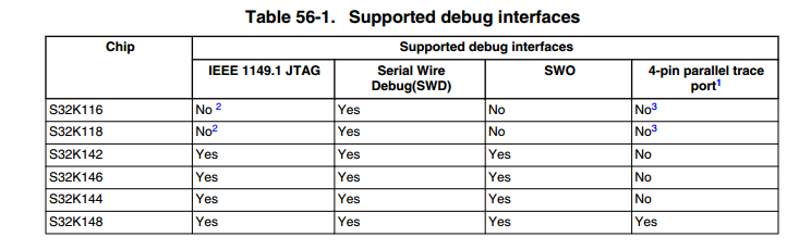

S32K146 does not support JTAG debugging

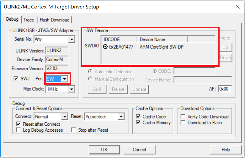

But I use ULINK2 on the development board to select JTAG and cannot connect
PTA10&PTC5 is configured as GPIO output mode and cannot output high and low levels

Please try to select SWD and connect the MCU. (You can press reset and click debug.)

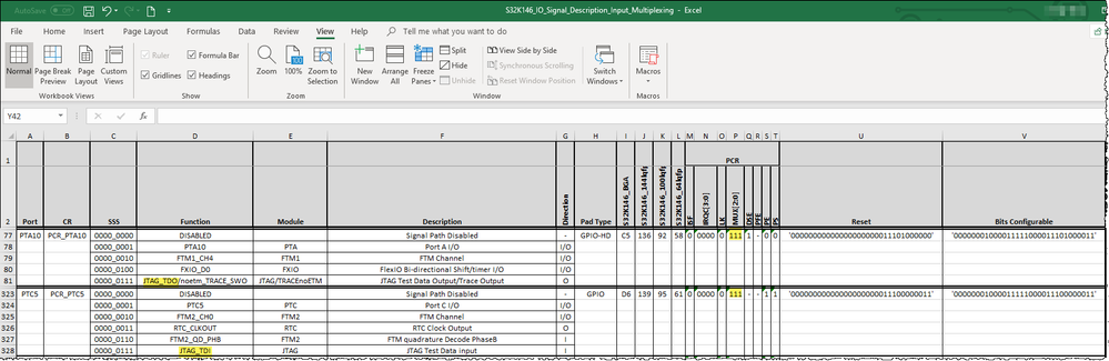

Please check the register value of PORT_PCRn, these two pins are default as JTAG function. (MUX=111)
If you want to use these two pins as GPIO, you need to configure is as GPIO function(MUX=001).

2. My debugger only supports JTAG debugging, not SWD debugging, so I want to know why JTAG debugging is not possible, is there a problem with my settings, it is possible to debug with a pirated SWD debugger, but our project needs Use genuine JTAG debugging to meet the requirements.

If you have to use JTAG debugging, then you should not use PTC5 and PTA10 as GPIO. PTC5 is default as JTAG_TDI and PTA10 is default as JTAG_TDO.

The debug port is not set as a GPIO port. The debug port uses the default configuration. As shown in the figure above, you can enter debugging by selecting SWD, and you cannot enter debugging mode by selecting JTAG.
