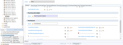

Please guide on "How to add multiple ConfigSet for a module".
I need to add another ConfigSet for the PWM module with different PWM channels.
There is no option as add configset for PWM module as shown below.
Is there any other option or method to add configsets for a module?

Hello @shubham_prajapati
As the PWM autosar specification, we cannot have two PwmChannelConfigSet in the configuration.
Regarding the question "Is there any other option or method to add configsets for a module?", could you please try the "Post build Variant" from the below thread:
https://community.nxp.com/t5/S32K/S32k146-MCAL-Variant-handling-at-configuration-container-level/td-...
