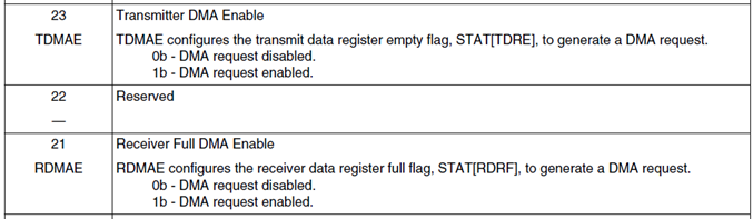

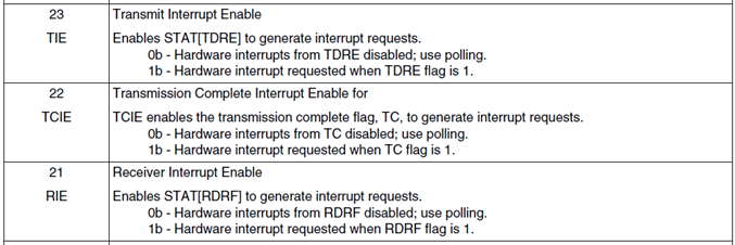

danielmartynek
Hello xiaoyuwang,
2. The LPUART allows to use DMA only for the transmitter.
3. No, the LPUART SDK driver can be used either in Interrupt or DMA mode.
4. The FIFO WATER marks can be used (FIFO, WATER).
But the SDK driver does no use it, TXWATER = RXWATER = 0.
BR, Daniel

danielmartynek
Hello xiaoyuwang,
Yes, it is not possible to use DMA only for the transmitter (LPUART TX) with the SDK LPUART driver.
There is no simple modification of the driver that you can do.
Why you don't use DMA for both the transmitter and the receiver?

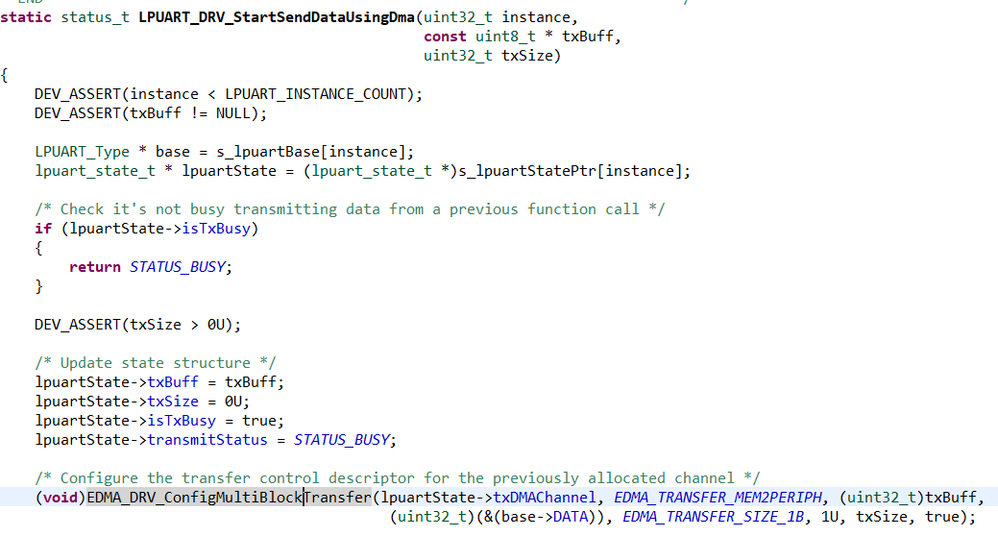

xiaoyuwang
hello Daniel,
We have a UART communication protocol, and communication frames length are not fixed value.
If I use DMA for UART reception, DMA will transfer communication bytes only one every time, currently I don't know how to increase the transfer efficiency.
One more question, I tried UART transmission with DMA, but I found a problem: My transmission success ratio only about 60%.
Picture above show you that I pack my data and call function interface "LPUART_DRV_SendDataBlocking" for transmission.
As shown in picture, I use default source code in SDK. I wonder how to increase the transfer success ratio.
Thanks again~~

xiaoyuwang
hi Daniel,
In my ECU, my MCU will communication with SOC chip with UART, and both Tx and Rx frames will observe the same communication protocol.
MCU will send frames to SOC according to task need. But currently, when I use send interface which mentioned above to send my frames, about 60% of them(Tx frames) are transferred failed. Which means only 40% of my Tx-Frames are send successfully. This is my success ratio.
For problem described above, I guess that is because of the 5th parameter of interface "EDMA_DRV_ConfigMultiBlockTransfer".  Currently, it is filled with "EDMA_TRANSFER_SIZE_1B", it is because of the byte width of DATA register of LPUART. But I think it is too slow that DMA will transfer only 1 byte every time. Can it be values other than  "EDMA_TRANSFER_SIZE_1B"?  How to configure?
Thank you ~~
13,512 Views
danielmartynek
Hi xiaoyuwang
As it was already discussed, the LPUART – DMA SDK implementation does not use LPUART FIFO, so, only the EDMA_TRANSFER_SIZE_1B can be used.
But the EDMA_TRANSFER_SIZE_1B parameter should not cause these issues.
Once the DMA transfer starts, it transfers one byte per a LPUART request, but it should not fail to transfer them.
What is the return status of the LPUART_DRV_SendDataBlocking() function?
Does it return TIMEOUT or any other error message?
Do you use other DMA channels with higher priorities?
