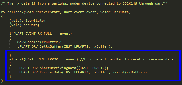

Hi expert,
I'm using S32K146 EVB to implement uart Rx and Tx data transfer.
I use LPUART in DMA mode both on Rx and Tx. I set BaudRate to 115200.
When I called LPUART_DRV_SendData too frequently(10ms periodly),I found that my Rx
Data Missing.
My code listed below:
#define MD_REC_QUEUE_LEN (100)
/* The rx data if from a periphal modem device connected to S32K146 through uart*/
rx_callback(void *driverState, uart_event event, void* userData)
(void)driverState;
(void)userData;
if(UART_EVENT_RX_FULL == event)
MdRxHandler(rxBuffer);
LPUART_DRV_SetRxBuffer(INST_LPUART2, rxBuffer);
}else if(UART_EVENT_ERROR == event) //Error event handle: to reset rx receive data.
LPUART_DRV_AbortReceivingData((INST_LPUART2);
LPUART_DRV_ReceiveData(INST_LPUART2, rxBuffer, sizeof(rxBuffer));
void ModemInit() //uart init and fisrt receive data
/* UART configured as follows:
- Word Length = 8 Bits
- Stop Bit = One Stop bit
- Parity = ODD parity
- BaudRate = 115200 baud
- Hardware flow control disabled (RTS and CTS signals) */
LPUART_DRV_Init(INST_LPUART2, &lpuart2_State, &lpuart2_InitConfig0);
EDMA_DRV_Init(&dmaController1_State, &dmaController1_InitConfig0,
edmaChnStateArray, edmaChnConfigArray, EDMA_CONFIGURED_CHANNELS_COUNT);
LPUART_DRV_InstallRxCallback(INST_LPUART2, rxCallback, NULL);

danielmartynek
Do you see the RX data from the modem on the bus using a logic analyzer?
Is there any error reported?

wjandsq
static void LPUART0_Rx_Callback_IRQHandler(void *driverState, uart_event_t event, void *userData) {
lpuart_state_t * s_lpuartStatePtr = (lpuart_state_t *)driverState;
if (event == UART_EVENT_ERROR) {
    ...... must
     LPUART_DRV_ReceiveData(INST_LPUART0, UART0_Rx_Buf, UART0_Rx_Buf_Size);
} else if (event == UART_EVENT_DMA_IDLE) {
} else if (event == UART_EVENT_RX_FULL) {
    LPUART_DRV_SetRxBuffer(INST_LPUART0, UART0_Rx_Buf, UART0_Rx_Buf_Size);
} else if (event == UART_EVENT_END_TRANSFER) {
4,015 Views

wjandsq
LPUART_DRV_SetRxBuffer   have  no  setting,  then the UART_EVENT_END_TRANSFER event  will  happen
