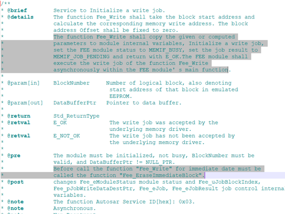

Answer from the RTD team:
"Below is the description of Fee_Write API.
Before we call the function "Fee_Write" call the function "Fee_EraseImmediateBlock"
What could be the reason of the pending state?
It is implemented by the code of the Fee module.
For specific details, you can view the code of module.
