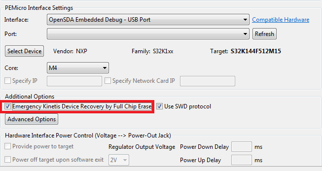

Dear all,
I got a problem about the flash programming.
I made a test project referred from a FLASH_Example of EAR SDK 0.8.2 and then I  executed debug mode on step by step procedure to verify an operation I expected.
After finishing debugging, an error message is displayed whenever I download new .elf to the EVB.
I think that I made a mistake when I use a flash command for partition or program with secure key...
you can refer to below error message I saw. please let me know how can I solve this problem.
===Error Message===
CMD>VC
Verifying object file CRC-16 to device ranges ...
block 00000000-0000610F ...
Error! CRC Command Timed Out
CMD>EM
Command is inactive for this .ARP file.
Error Erasing flash of device
Error occured during Flash programming.

Hi Young,
This is a know issue of the Flash example and it will secure the device.
To make the board usable you need to perform a mass erase of the chip. Open the PEMicro debug configuration and select "Emergency Kinetis Recovery using mass erase" in Debugger tab. This will perform the required mass erase and will make the board flashable again.

youngsamkim
Dear Rares,
Thanks for your support. The problem has been solved by your advice.
