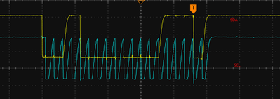

I use FLEXIO as the Master for I2C, and I call the SDK library functions I2C_MasterSendData and I2C_MasterReceiveData to read the registers. I wonder why the SDA and SCL captured by the oscilloscope are not normal? What causes SCL to be not a square wave but a triangular wave?

Hi @LzdOo
Does the flexio_i2c_s32k144 example work without modifications?
Also, for I2C communication, pull-up resistors are required on both the SDA (Serial Data) and SCL (Serial Clock) lines to ensure proper functionality. These resistors are typically in the range of 2kΩ to 10kΩ, depending on the bus speed and capacitance. Have you connected them?

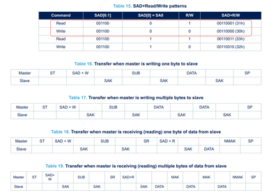

Slave address is 0x18, the address of the register to be read is 0x0F.

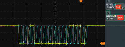

Based on the waveform, it seems that the code only executed the part for sending the SUB address, but did not execute I2C_MasterReceiveData. What could be the reason for this?
(The I2C timing sequence is as shown in the following figure.)

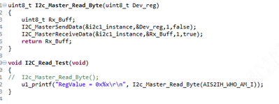

If possible, could you please share your project files or code? That way, I can take a closer look at the implementation and configurations to better understand and visualize the situation.

Sorry, my code is encrypted. Please explain based on your experience the possible reasons for the aforementioned phenomenon.

VaneB
Hi @LzdOo
You could try swapping out the 10kΩ resistors on the SCL line for ones with a lower value. Take a look at the waveform to see if there is any noticeable difference.

Could you please tell me how I can modify my code?
(Both my SDA and SCL have 10KΩ pull-up resistors connected to them.)
