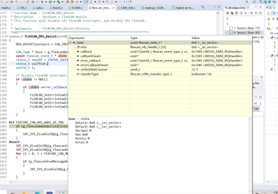

i am building a bootloader, so i need to  CAN_Deinit before jump to app ,but everytime the program will into hardfault when the program into the sdk api called
FLEXCAN_DRV_Deinit  ,
when i debug ,the picture shown above,
hope your reply
1,526 Views
zq1
enter the program will into hardfault in  if(FLEXCAN_IsEnabled(g_flexcanBase[instance]))
hope your reply
1,465 Views
PetrS
be sure module is clocked. Check respective PPC register.
