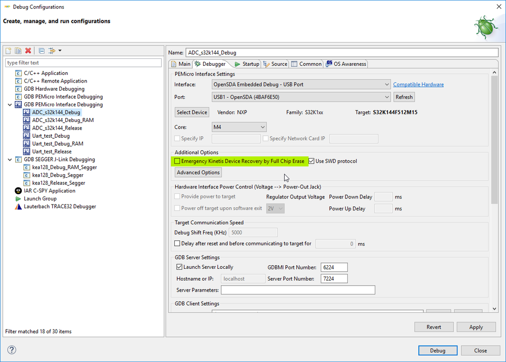

Hi Jay,
If I remember it correctly - there is some issue with PE Micro plugin related to memory preservation.
You can try remove Memory preservation for FlashNVM range. Also emergency kinetis device recovery may help:
Jiri
