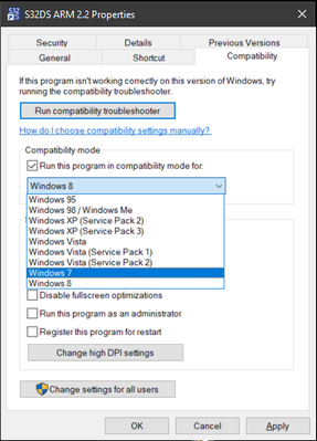

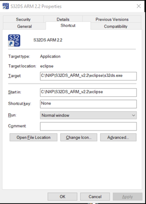

This is however outdated version of Design Studio.
Newest version suitable for S32K1 device is either
S32 Design Studio for S32 Platform v3.5
https://www.nxp.com/design/software/development-software/s32-design-studio-ide/s32-design-studio-for...
or possibly
S32 Design Studio for ARM 2.2 (which is latest version what you have installed):
I would recommend to use v3.5 as it is maintained.
If you are using 2018 ARM version, you could try to run it with windows 7 compatibility mode:

Have you tried to run the installer in win7 compatibility mode? I guess it will be possible with Windows 11 as well.
I just discussed with DS expert and I have been confirmed version 3.5 should work with Windows 11.
