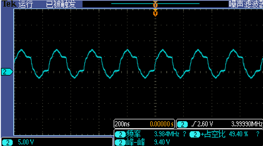

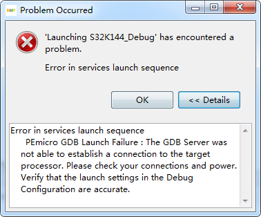

      I am debugging the S32K144 and configuring the MCU and Prot using EB. Put PTB5
Configured as CLKOUT with a frequency of 4MHz. Then the program cannot be downloaded again (debug). But after I power it back on, I measured that PTB5 is still 4MHz output. I don't know what caused this.

I have solved this problem because the chip is locked
