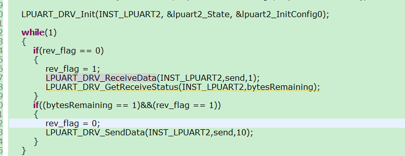

I have came up with one problem.I wanted to write the drive of Uart.Now the drive of Uart sending  data has been completed.But the drive of Uart recieveing data could not complete.My method is that When S32K144 MCU recieve data from upper computer ,the MCU will send teh data has recieved. But upper computer could not recieve data .It could go into Recieve  interrupt.So plz help.

I write Uart driver with SDK.My code is follow.Upper computer send data to S32k144.S32k144 send the data recieved from Upper computer.

Let me apologize for the late response.
The second parameter of the below function expects the address of the bytesRemaining variable.
Also, you can check the status.
      /* Check the status */
      status = LPUART_DRV_GetReceiveStatus(INST_LPUART2, &bytesRemaining);
      if (status != STATUS_SUCCESS)
         //do something
Do you have still some issue? Can you share your project? If you cannot share it on the community you can send it directly to my email address.
I can try to look at it.
