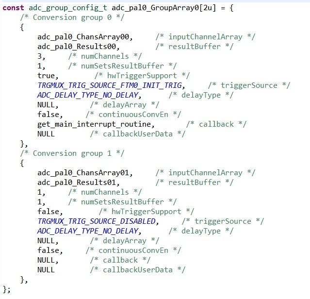

Hi,I want to set SW trigger and HW trigger in one ADC module using adc_pal,for example ADC0_Ch0,Ch1,Ch2 are triggered by HW (FTM),and ADC0_Ch3 is triggered by SW,but it seems that the SW trigger group doesn't work after calling ADC_StartGroupConversion(),is that invalid to set SW trigger and HW tirgger in one ADC module?

HW and SW trigger on the same ADC cannot be combined.
