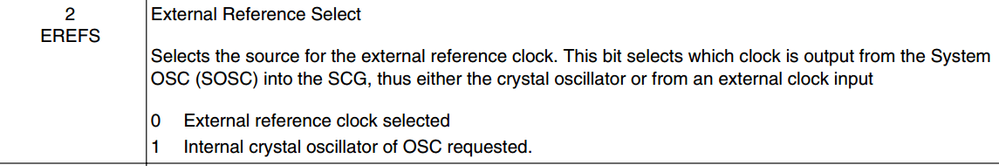

   I have a problem,In the demo the
   SCG->SOSCCFG=0x00000024; /* Range=2: Medium freq (SOSC between 1MHz-8MHz)*/
                                                         /* HGO=0: Config xtal osc for low power */
                                                         /* EREFS=1: Input is external XTAL */
   means we used external XTAL,but the datasheet means 1- Internal and 0 - external
I am confused,who can help me?

The clock can be either an external clock on EXTAL pin [EREFS = 0], or output of the internal SOSC with an external crystal [EREFS = 1].  As you can see in the screenshot below (Figure 25-1, RM).
