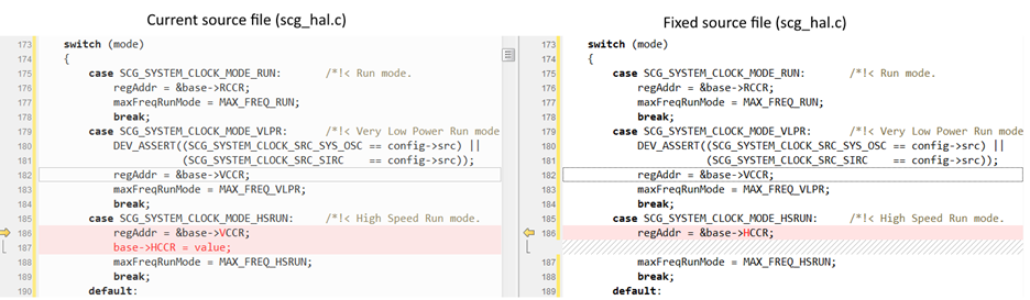

  • The option 3 in the menu is not working for me. Don't know why? This is true with and without the debugger, in fact when the debugger is running when I choose option 3 it resets, is due to clk frequency? I thought the core ,bus clocks are active in this mode?

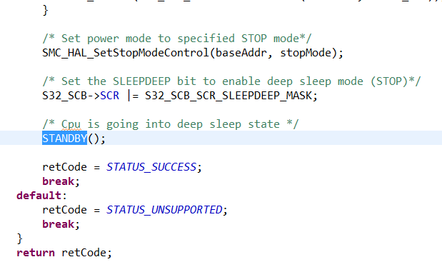

  • There is no "WFI" instruction before entering the varius low power modes, why is that?

SMC_HAL_SetPowerMode() in smc_hal.c uses STANDBY() function:
s32_core_cm4.h

This is caused by a bug in a clock manager component.
To fix it, in the PowerManager example project in DSK/platform/hal/scr/scg/scg_hal.c
change regAddr = &base->VCCR  to regAddr = &base->HCCR (line 186)
remove line 187 with base->HCCR = value
This bug will be fixed in the release after RTM SDK (0.8.3).

What about my other question regarding the instruction "WFI" , IN THE DATA SHEET IT IS SAID  ENTERING A LOW POWER MODE  IS TRIGGERED BY "WFI" ,however it is not used in this example anywhere?
What is the story there?
