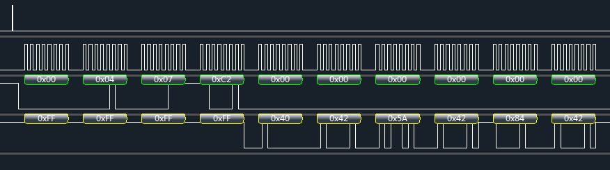

problem of S32K144 LPSPI
I used  GPIO PTB14,PTB15,PTB16,PTB17 as LPSPI1‘s Pin,SPI send is ok(the signa PCS is i simulate),
the send waveform like that
but after received six bytes,it rest on
while((LPSPI1->SR & LPSPI_SR_RDF_MASK)>>LPSPI_SR_RDF_SHIFT==0);

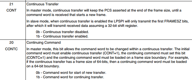

I found is the pastedImage_1.pngis disabled,but when i enable CONT and CONTC,the send is abnormality,if i want to use continuous model ,how can i config those registers。thanks for your help!

danielmartynek
During a continuous transfer, if the transmit FIFO is empty, then the receive data is only written to the receive FIFO after the transmit FIFO is written or after the Transmit Command Register (TCR) is written to end the frame. (Section 49.4.2.2, RM rev.7).
You can end the continuous transfer with a new command where CONT = 0.
