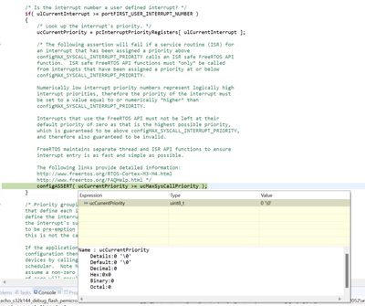

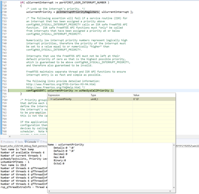

I was trying to set an event from UART recieve ISR call back function using FreeRTOS API "xEventGroupSetBitsFromISR()",
but the code execution got halted in "configASSERT( ucCurrentPriority >= ucMaxSysCallPriority )" of function - void vPortValidateInterruptPriority( void ) [port.c].
During debugging, it was observed that the priority of the calling interrupt was set to '0', as determined by executing the line:
"ucCurrentPriority = pcInterruptPriorityRegisters[ ulCurrentInterrupt ]"
so eventully the execution is stuck in this assert statement ("configASSERT( ucCurrentPriority >= ucMaxSysCallPriority )").
Also tried in existing FreeRTOS example code from s32 SDK, still execution halted in same assert statement
Is there any way to fix this

I have modified the code by changing the interrupt Priority using above mentioned API "INT_SYS_SetPriority"
Still its getting Priority value as "Zero"

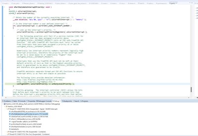

I am facing this issue in all the freeRTOS codes which uses "FromISR" API, even i tried with the samples provided by S32Design studio.
Currently i am trying the sample "freertos_s32k144" in this particular example, from a button ISR handler there is  freeRTOS function call "xTimerResetFromISR( xButtonLEDTimer, &xHigherPriorityTaskWoken ); , Even this function call end up in the same configASSERT.
I have attached the call stack and the sample code for your reference.

PetrS
as description outlined, for LPUART assign lower ISR priority (numerically higher number) then configLIBRARY_MAX_SYSCALL_INTERRUPT_PRIORITY is.
In SDK interrupt priority can be changed just by calling INT_SYS_SetPriority in your source code, otherwise the SDK will use default priorities of the hardware.
