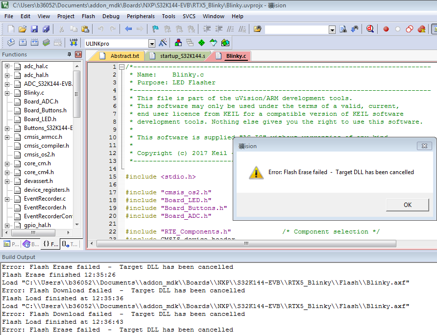

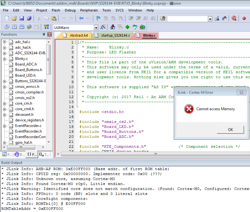

I might inadvertently secured the S32K144 device. (Erase all, containing the 0x40c secturity bytes)
So I tried your above method, but the MDK could not execute "mass erase", it always errored as "Flash erase failed". I tried J-link and Mulitilink P&E debugger, but they all failed. Please see the infor as below, could you advise how to erase and unsecured S32K144 in this case? Thanks a lot!
Debug set as P&E, error infor:
Debug set as "JLINK", error infor:
5,789 Views
