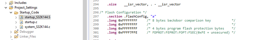

Hello.
I am using S32 Design Studio for Arm V2018.R1 to program the S32K144 device.
I need to program the Flash Config Field at address 0x0_040D: I have to disable external reset pin.
How can I do  ?
In the case it is not possible using S32 DS, do you know another way to do this ?
Thank you.
Nicola
2 回复数
2,209 次查看
danielmartynek
Hello Nicola,
You can change it in the startup_S32K144.S file
