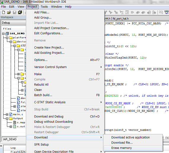

I am trying to program a S32K144 via the Multilink in IAR work bench. The board has been working fine before., but then it shows the "Device is secure.Erase to unsecure". I keep pressing Yes.
AFter doing this twice the "Multilink" not connected is shown.
How to solve it? Kindly give me some suggestions

If you are using IAR, you can erase Flash with following step.
1. Project >> Download >> Erase memory.
2. select erase all.
3. PEMICRO connection manager comes up. then connect debugger.
4. Flash is erased.
Lukas

Hi Mr.Lukas,
     Sorry for the delay,I have tried that,the problem remain same when i trying to connect through connection manager, its shows the "Device is secure.Erase to unsecure" pop up window.
Kalidass B

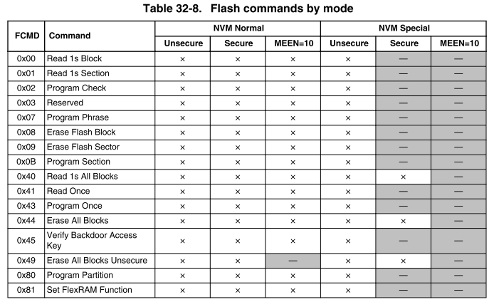

lukaszadrapa
I do not have IAR installed, so I'm not sure how they implemented this function. Debugger is allowed to execute Erase All Blocks Unsecure command when the device is secured:
Try to ask IAR if it is supported by their implementation.
