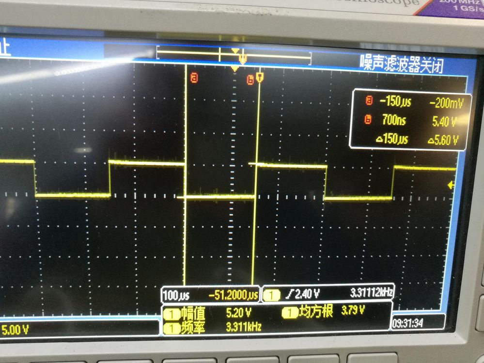

I am using FTM OC function, but when I use SDK to configure my OC channel, I got some doubts.

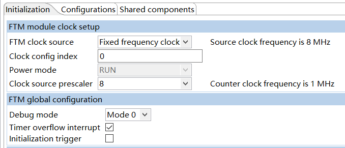

1. Clock source frequency after prescaler is 1MHz.

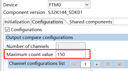

2. Max counter value set to 150. Means I need to set the output pin curve period for 150us.

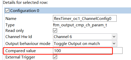

3. Channel compared value set to 100. Means I want to toggle output pin when at 100us.
RESULT: I got following curve.
Both high level and low level duration are 150us.
MY QUESTION: What's the meaning of compared value which set for channel? How to use it?

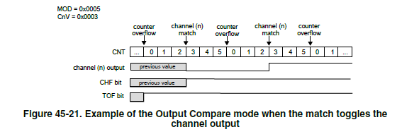

Compared value is the moment when the output action occurs. In our case the signal is toggled. So, your assumptions are right.
Compared value can be used to generate phase shifted signals, generate event after some period of time and so on.
I can provide you more details if you can detail your application.

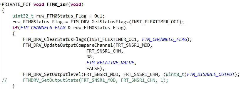

Step 1: I want to get a 150us pulse and I set FTM0 module clock 250KHz, 4us every tick.
Step 2: I called function "FTM_DRV_SetOutputlevel" in my task to control to start channel and set match mode to "FTM_SET_ON_MATCH".
Step 3: Set match value to 38 and set relative value.
   Means I will stop channel once channel interrupt is got. And waiting for next task schedulation.
Step 4: Run my task for 50ms  period.
ISSUE 1: The pulse period is 50ms, it is correct. But pulse width is changed from 50+ to 152us every task period.

i know why now.because i did not update the cnv value.if i set the cnv 100,set the MOD 150,the first match happen with the channel output flip,when CNT count to 100,spend 100 count time.the second match happen with the channel output flip,when CNT count to 100,spend 150 count time(50+100).
so the waveform will behave like 150 count time.

Based on the details provided by you I suppose that the pulse width is not always the same due to software overhead or because other taks/interrupts are handled.
Can you explain what signal are you trying to generate? In this way I can try to provide an better alternative to implement your software.
