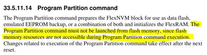

I am working on S32K144  Flash Memory. I want to do partition for 4KB EEPROM and 64KB backup. While partition when I am writing 1 to clear CCIF and again wating  for 1 to complete the process, in while loop it is going to reset handler but when I am debugging step by step then it is not going to reset handler. I am not able to understand.
/* Clear CCIF to launch command */
p_stgFTFCRegAccess->FTFC_FSTAT |= FTFC_FSTAT_CCIF_MSK;
while (0U == (p_stgFTFCRegAccess->FTFC_FSTAT & FTFC_FSTAT_CCIF_MSK));
Please help.

OK, I have managed to solve this problem, even though this was not stated ANYWHERE before and is done implicitly in all examples I have seen (SDK and No SDK). By implicitly I mean, the code is written of course but there was no stressing on this fact and no mention of it in the application note AN11983.
The solution is to put command launching in a function and place this function in RAM as follows:
void launchCommand(void) __attribute__((section (".code_ram"))); //attribute place the function in RAM. No need to repeat for definition
Also enabling FTFC_IRQn before you partition the flash memory using pure software (i.e. flash not partitioned by PE Micro Debug configuration, like "Enable Device Partitioning" and "Preserve Memory Area")
Hope this helps anyone

It looks like this is the reason. Try to execute the code from RAM.
